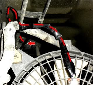

Was under checking length of glow plugs today and noticed a snapped wire on a connector.
It doesn't cause any problems, unless this is my glowplug problem, but can anyone tell me what it is.
There are a few connectors bundled together.
Driver+Passengers
Posts: 2019
Location: Fife
Re: Whats this wiring?
Post by Driver+Passengers » Wed Nov 07, 2012 11:10 pm
Four vacuum valves on top of that bracket (top of the intake manifold, under the accelerator cable).
Right-hand two are cold-start, left two are EGR (?) Is your EGR blanked or still active?

if you remove or break an earth here the ecu thinks there is a fault and can stop the dash glow plug light working and turns them off, in some cases it can isolate the fuel pump and stop the bongo from startiing at all.
just below these solenoids is a bundle of earth straps that are bolted to the inlet manifold. (just seen in the last picture).

Agree with the comments above.. The EGR looks to have been blanked & the redundant solenoids removed..?
From memory there is a 5volt currant coming off the ECU & it can do some funny stuff if any of it grounds when & where it shouldn't, especially the positive side... :?
If you wanted to tidy that aria up? There would be no harm in removing the connectors & shielding the cut wire ends...
If you do decide to cut them..? Do it one at a time, not both at the same time!!! :idea: But you knew that any way! :wink:

It doesn't cause any problems, but how can you tell EGR valve is blanked off.I am not very mechanically minded, just bodywork.

Under your finger and along the top of the inlet manifold looks like your EGR pipe. If this is not there, you've been blanked, but as it's there you'll have to work out whether it looks like there is a couple of mm aluminium blanking plate or similar sandwiched between that pipe and either end to where it connects (inlet corner piece towards the front and EGR valve towards the rear).

From the picture it looks like it is the wee extension loom going from the connector to the temperature sensor(ECT)I think it should have a blue and red/with a tracer (think it is green)wires.
Can you trace the loom back..

Temp sensor for what? I dont think my scavanger fans work but not sure how to check them, difficult to trace as it just disapears into a clump of wires.

stuc wrote:Temp sensor for what? I dont think my scavanger fans work but not sure how to check them, difficult to trace as it just disapears into a clump of wires.
Its the Engine Coolant Temperature Sensor,it screws into the engine just below your finger,(In the picture)t this sensor is used by the ECU to perform various functions,one being the Glow plugs.

Another being the rad fans! :shock: Double check the wiring to it is present and correct (item 26 in the first picture http://mazdabongo.wikispaces.com/Parts)
Scavenger fan is controlled by temp sensor poked down through the centre cowl (item 25).
Not that they're anything to do with EGR solenoids. ;)
