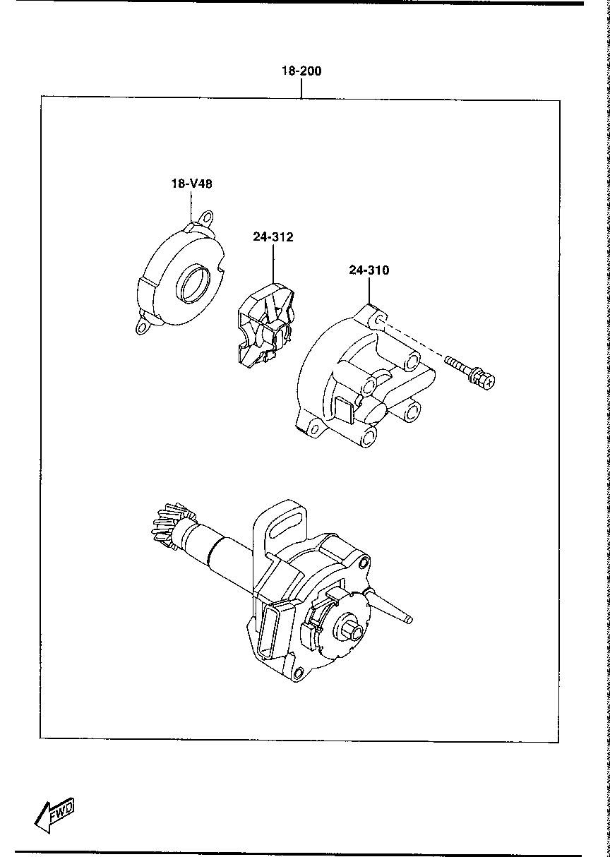

Thought there was a sensor built into the distributor itself (below the cap), it certainly has a socket for a connector!
See the diagram, lowest part with the connector jutting out on the left;
Someone had a recent problem with the V6 version and the sensor had been damaged internally and wasn't working at all in there case.
