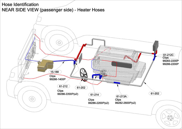

Install completed, except might have to re-route the waterworks in case I have plumbed it in backwards as such, a road test will prove that.
Or is there a diagram showing water flow direction for the Bongo's??
It also become apparent the air bleed pipe really needs a header tank!

These diagrams come from widdowson2008 threads http://www.igmaynard.co.uk/bongo/forum/ ... 49#p360049
but I always spend ages finding the right picture in the threads so keep a copy myself!

g8dhe wrote:These diagrams come from widdowson2008 threads http://www.igmaynard.co.uk/bongo/forum/ ... 49#p360049
Ahah - I have it tee'd into the blue 61-214 pipe, so its circulating the wrong way as I thought, well actually the right way but via the header tank & everything else etc, , mighty effective going that way haha
