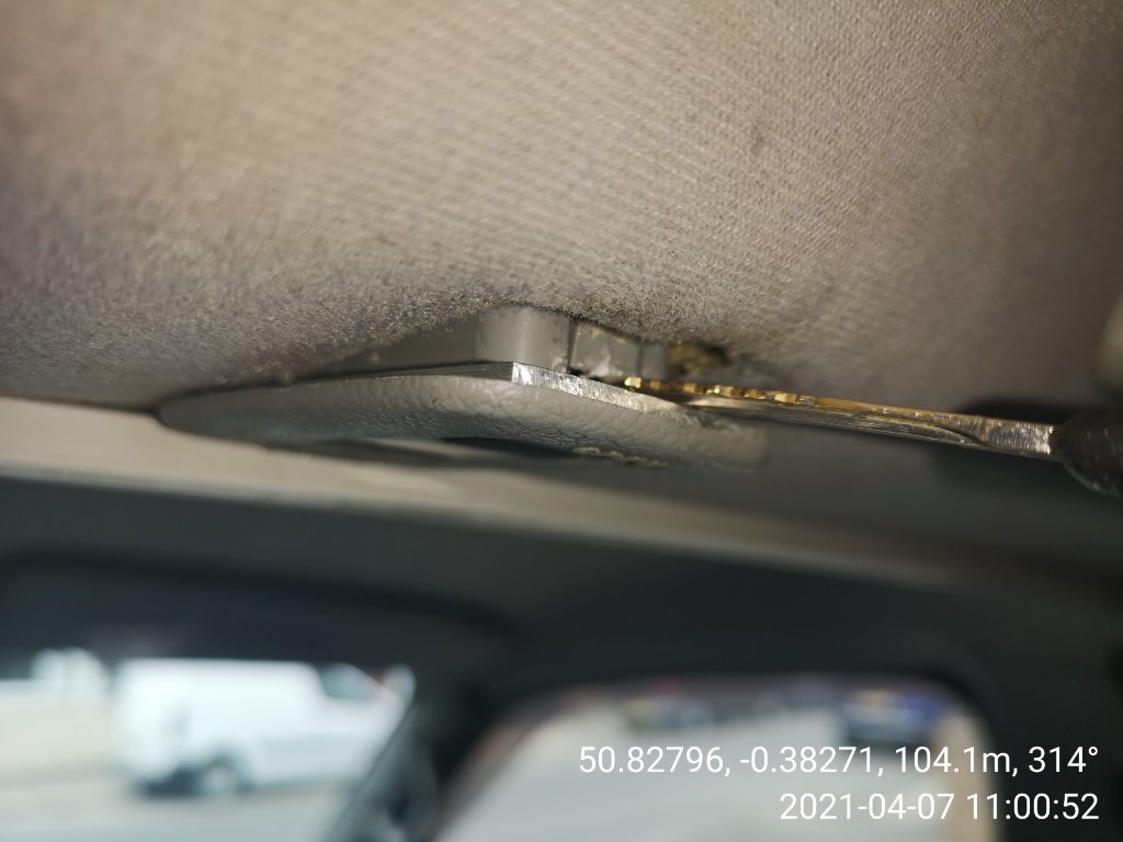

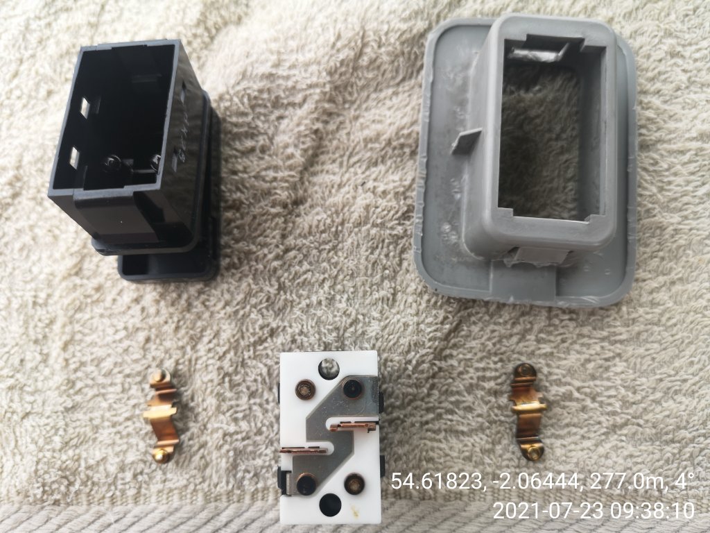

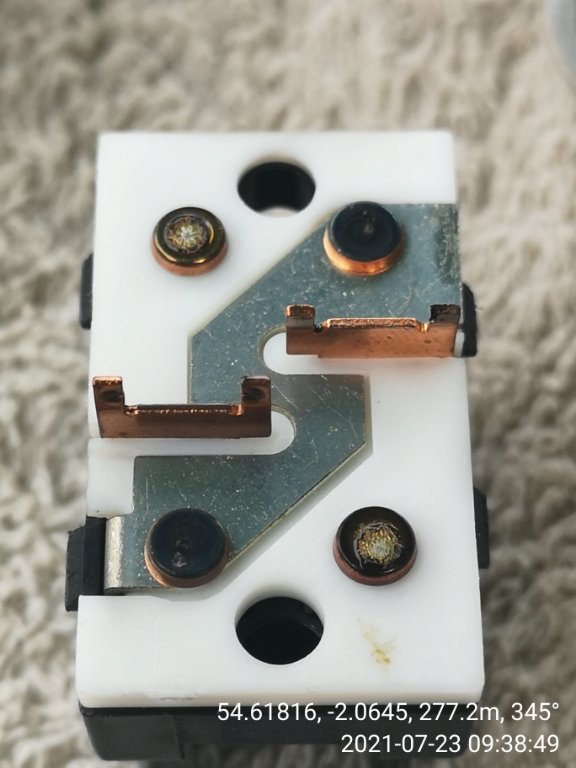

Have you tried cleaning the switch in the front cabin roof, that controls Up/Down ? The switches get very dirty!
To get it out using the ignition key to depress the tab on the surround
Then open up the switch
clean the contacts.
clean the contacts.
