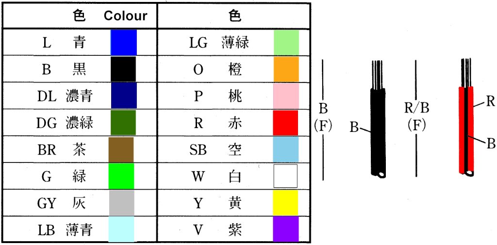

Not had any reports of colour changes, there are some fuse position changes after 2001 which are noted on the Tabs. Colour codes are as;
The only point to bear in mind is that these are the Loom colours, on some devices the wiring between the loom connector and the device can vary as they are made by various suppliers and not always as standard but this shouldn't affect the AFT as the loom plugs directly into the module, but things like roof lights may have some odd colours entering the device.

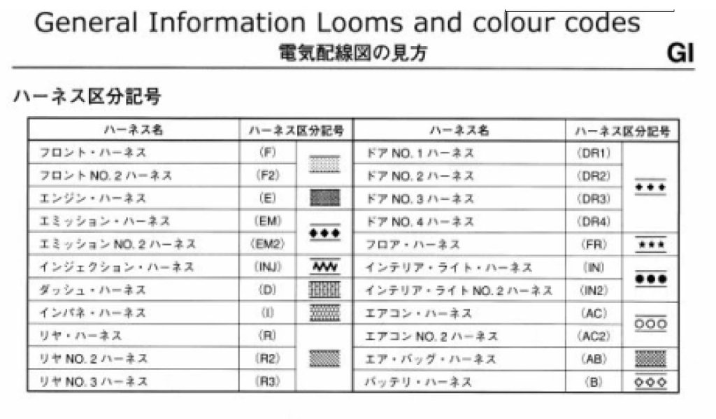

Do you know what the (IN) and (F) adjacent to the colour signify?
- g8dhe
- Posts: 10246
Re: Login issue
Yes there the Loom Names
