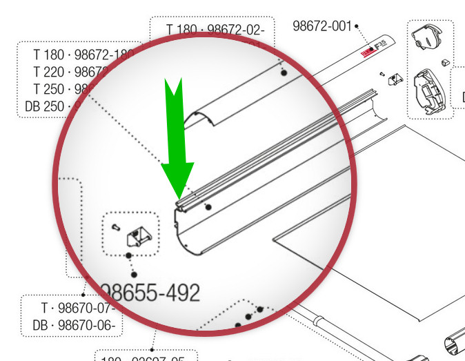

Isn't there a figure of 8 slot on the top rear of the cover? I've arrowed in green...

theere is nothing like that on mine.
http://www.vanline-ni.com/18070?languag ... 0wodLBMNXQ
Just under the red thing is a channel I Thought was for Kaodr strip but does not fit

Ah I see, they use the outside of the slot for the clamp and I guess the inside of slot itself isn't accessible to put the Kador strip in ?

even the part available is too small to put the Kador strip in. It appears to be a function of bending the mounting section.
If the Kador strip had fitted I would have permamently fitted in between the two mounting brackets.
the top slot is too small for small side and bottom slot is too large for the large side.
