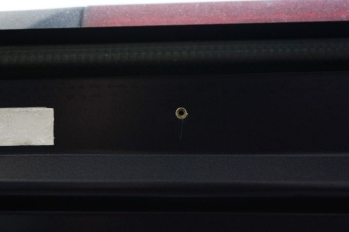

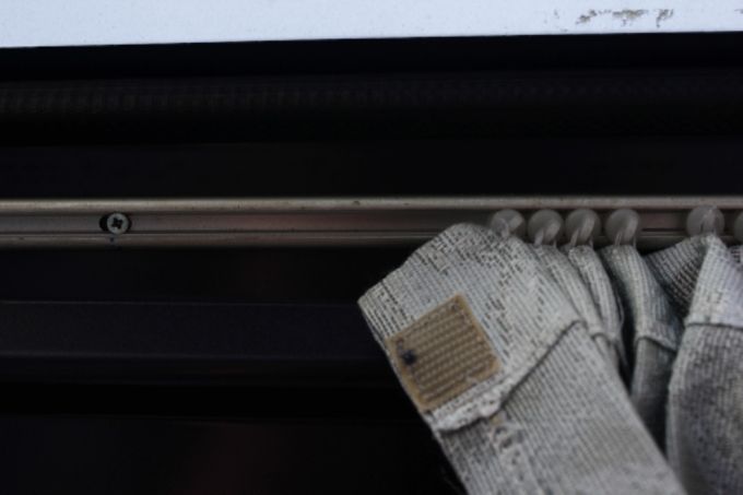

Taking all the advise here at at work

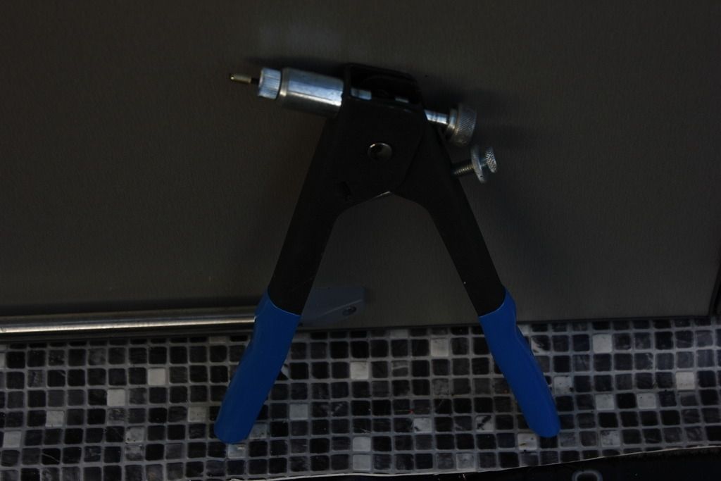

I drilled a pilot hole and decided that the rivnut / clinchnut was the best option.
An insert is swaged into a precise hole drilled into the sheet metal. A machine screw can then be used (3mm)
tool with brass bodied clinch nut

Just for others that may want to do the same job "would ordinary pop rivets" do the job ?.
Simon Jones
Posts: 9341
Re: What size are the self tappers for rear curtain rail?
Post by Simon Jones » Sat Feb 13, 2016 3:28 pm
Two difficulties with that:
- finding a rivet with a small head to sit deep enough to clear the curtain hooks
- you'd need a small collar to form a temporary spacer between the rivet gun 'nozzle' and the head of rivet otherwise you risk deforming the rail as the tool compresses against it.
Totally do-able though. I fxed the spring steel ends onto the middle rail using this method.
