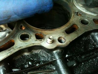

Can you tell me how to remove this spigot please.
It looks easily damage, can it be replaced?
Adam
Simon Jones
Posts: 9341
Re: Block Decking
Post by Simon Jones » Sun Mar 28, 2010 10:41 pm
That's the oil feed pipe. Bellhill Garage do them for a couple of quid along with the 2 locating pegs that ensure the head is perfectly aligned. The best way to remove it is to use a can of freezer spray & shrink it out (again, thanks to Tom at Bellhill for this invaluable tip). I originally tried a cheapy pair of 'mole' grips but all it did was to chew the metal up. Invest in genuine mole grips which have much sharper teeth. Use the freezer spray on the pipe for at least 30 secs until it's really white & then clamp the mole grips round it & give it a gentle twist. With a bit of luck, it will come loose quite easily as it's just a push fit. Don't be tempted to use heat on it as it will cause it to expand quicker than the surrounding metal & grip even tighter.

Simon Jones wrote: Don't be tempted to use heat on it as it will cause it to expand quicker than the surrounding metal & grip even tighter.
If SImons advice doesn't work out of the box (which with luck it will) then there's a variation on this I used with great success for a mate many years back. Get the block heated as best you can AND THEN use the freezer spray. The large mass of the block will not respond to cooling as quickly as the focus of it and you might just get an extra edge in loosening the item as it shrinks quicker than the heat expanded hole around it does. Worth a go if all else fails 8)
