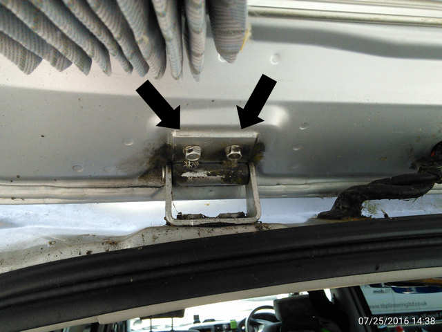

I assume from what you say its out of line when in the closed position, i.e. its dropped ?
In which case surely the two pairs of bolts on to the tailgate hinges themselves need adjusting to get the height correct when closed ? see below;

Cheers Geoff....when it was loaded up, the latch on the tailgate fouled the rubber weather seal and plastic trim of the footplate before it touched the striker..so yes...like the door had dropped downwards..
Are those bolts adjusting bolts then ? If so, how do they adjust?

Re: Adjustng tailgate
There isn't an adjustment as such, more a case of loosen very sightly one pair at a time and then tap the door "up "a little and then see how it fits ? If they have moved I would suspect that the paint will be cracked between the plate and door, on ours the door has been adjusted in the past and then resprayed I believe as the paint covers the join!

Ahhh....I see what you mean...my brain hadn't made the 90 degree transformation! Will take a look tonight if my wife is still up to propping the tailgate up without the struts in !

Well..here we have it...having ordered a set of originals the difference is obvious...don't reckon those sgs ones Compress down as much....
Even fitting the originals the latch was catching a little but luckily there was a fair amount of play at the hing bolts as you can see...all good now..door shutting fine, 150 quid out of pocket and I'm routing a block of wood tomorrow to chock the struts when the box is on instead of any more faffing...leaving on Tuesday and no time left..
