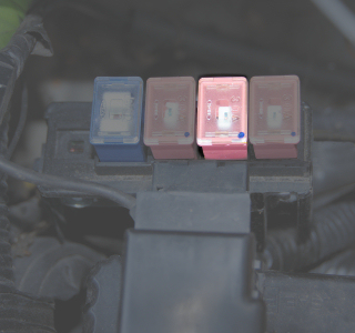

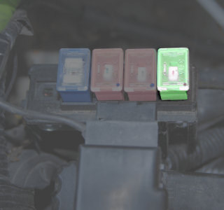

A quick check you could make is to turn the Air Conditioning on (if you have it) that forces the Fans on, that will prove that the Fans and the relays are OK or not, if they do come on then it would suggest that perhaps the fault is back towards the ECU and temperature sensors (most likely) if they don't come on then it would point towards the Fans, relays and fuses the fuses are;
Image Image Image
the relays are B6-01, B6-02 & B6-03 see top lefthand side;
