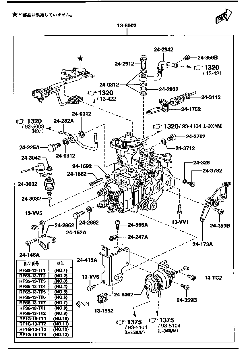

thats the one im on about jaylee,the solenoid on the left! the right one picks up the throttle in cold start mode and aircon on mode,but does the one on the left control the drop off further when the engine is in tickover mode with no load on it. i think it does.jaylee wrote:Ady, this may or may not help...?http://www.igmaynard.co.uk/bongo/forum/ ... f+the+week

Northern Bongolow wrote:thats the one im on about jaylee,the solenoid on the left! the right one picks up the throttle in cold start mode and aircon on mode,but does the one on the left control the drop off further when the engine is in tickover mode with no load on it. i think it does.jaylee wrote:Ady, this may or may not help...?http://www.igmaynard.co.uk/bongo/forum/ ... f+the+week
I know it refers to auto... & there may be a little change in engine stride when it drops out or kicks in, but my RPM stays at around the 750..
What i discovered about the one on the left before i replaced the dud solenoid on the right, is that the plug warming on cold start the solenoid activates 24-8002 http://www.lushprojects.com/bongopartsmk2/1R29921.gif hoiking the revs to 750 as if warm acting like a choke i suppose? then drops off long before i would call a decent running temperature?? (That whole auto box lock up thing?)

Yer cold start revs seem a little high..? You may need to adjust the screw on 24-173A http://www.lushprojects.com/bongopartsmk2/1R29921.gif Or that equivalent..
Mine is set to compensate for normal tick over... I think?
